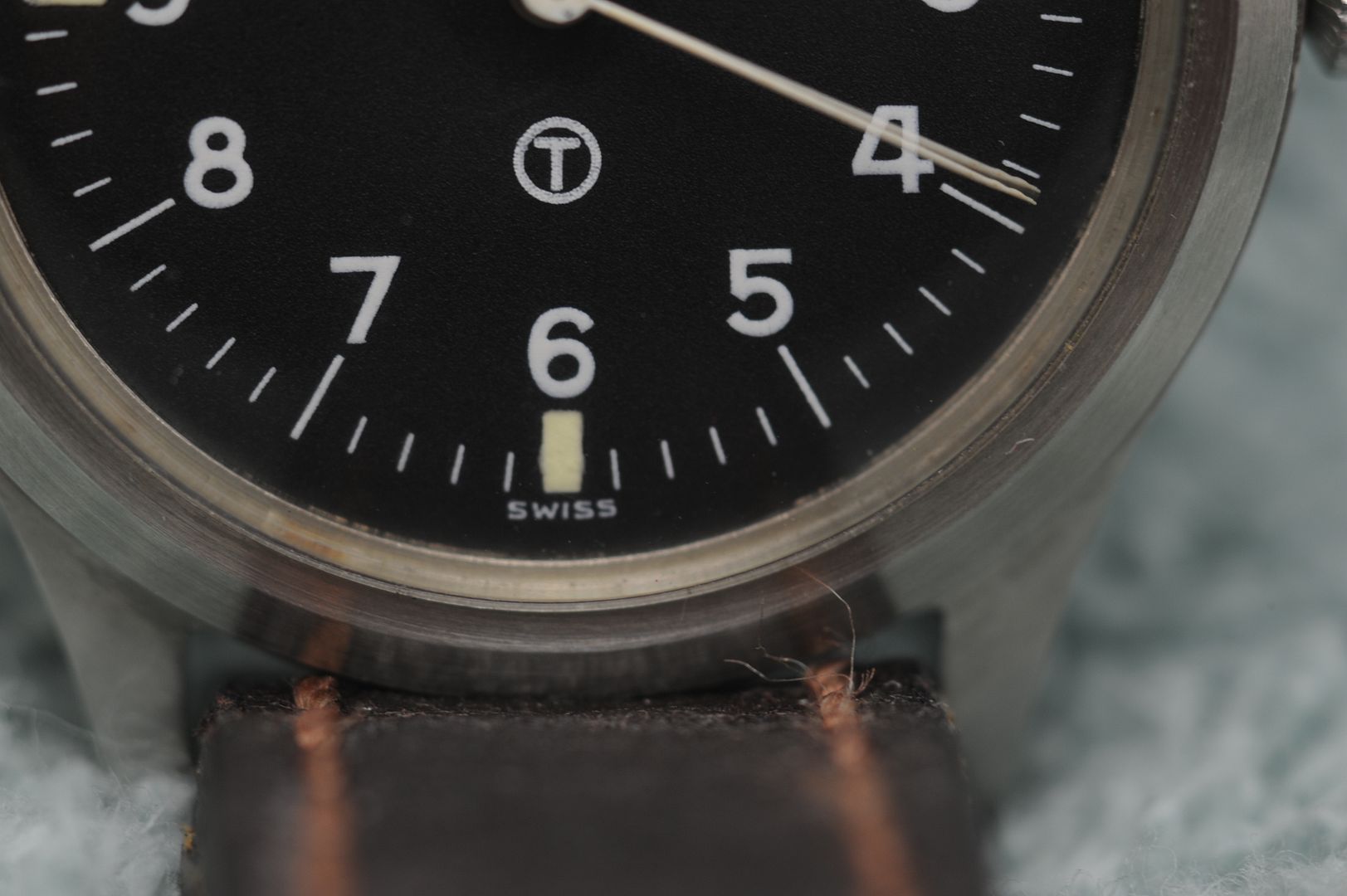

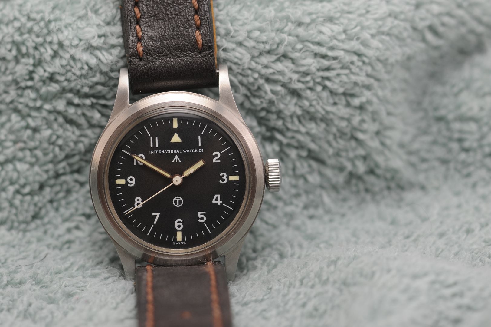

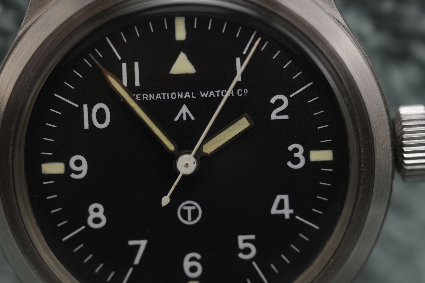

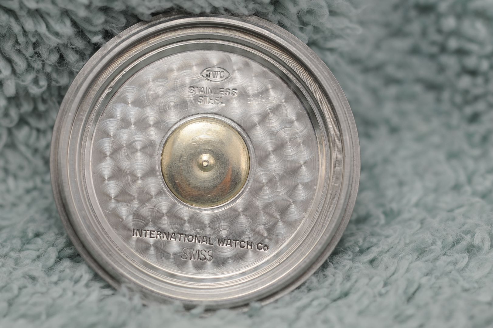

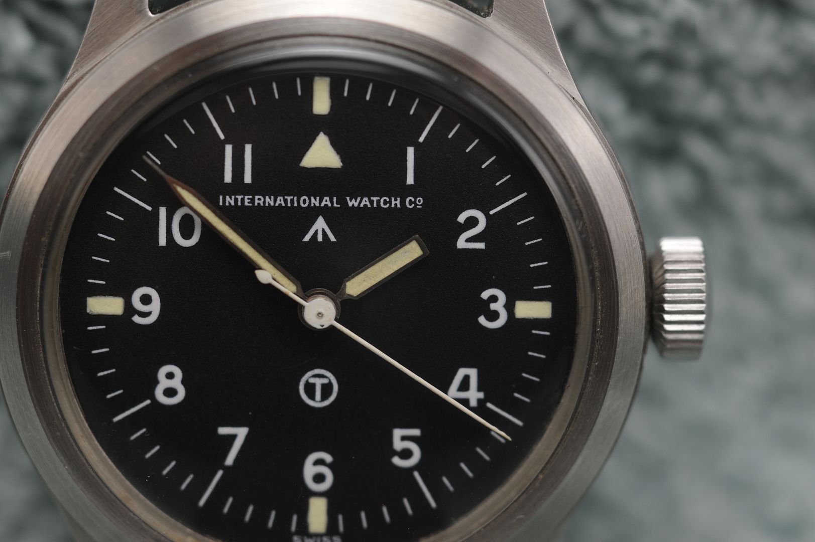

    After searching for several years, I've finally acquired a lovely Mark XI in near mint condition. The case and dial look almost NOS. Unfortunately, the movement seems to have been treated harshly. It has some brassing and numerous scratches and dings. It just had a service by a very reputable watchmaker here in the US, and appears to be keeping good time.
    I purchased this watch from a collector in the US who purchased it from a German collector. The German collector got it from the original owner. That is the only history I have.
    I'd love to know a bit more about this watch and am hoping that someone on the forum has seen it before?
    All comments and criticism greatly appreciated.

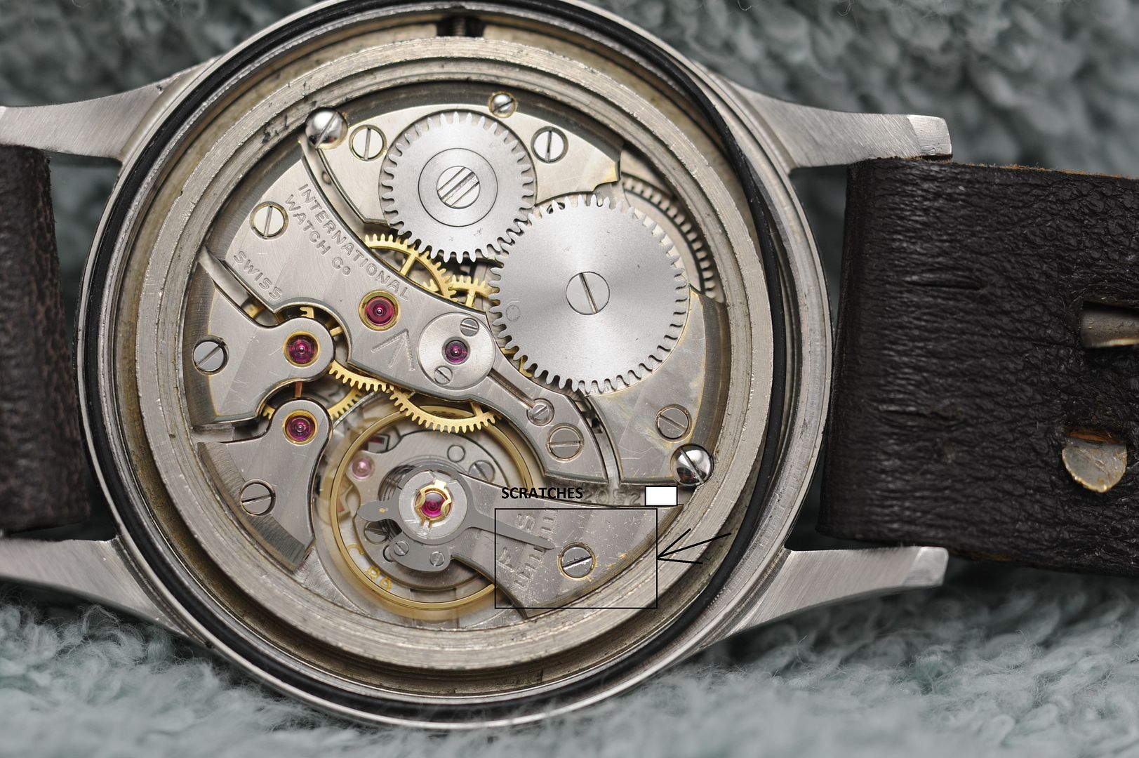

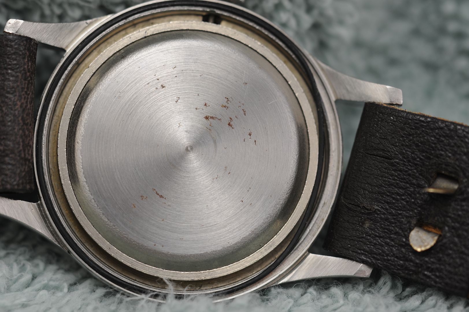

    Movement has plenty of scratches and dings. Plus evidence of sloppy work in the form of damaged screw holes.

    A very nice looking example. Congratulations.
    That sloppy work on the movement is the work of Chronometer Department of the Royal Observatory at Herstmonceux. Treasure it.

    OK, thanks. I googled and read about the observatory.
    Was sloppy work the norm for them?
    Someone mentioned to me that this watch looked like it may have been restored at Schaffhausen. I see no indications of restoration anywhere on this piece. Do you?

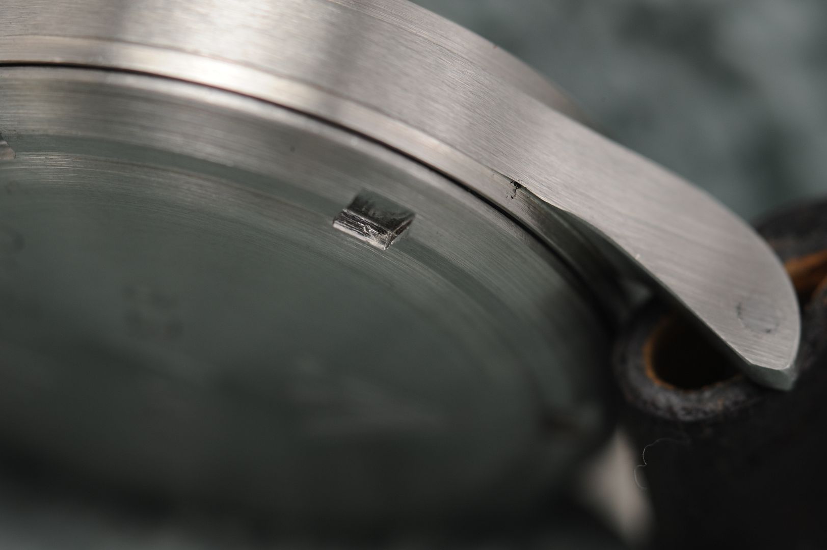

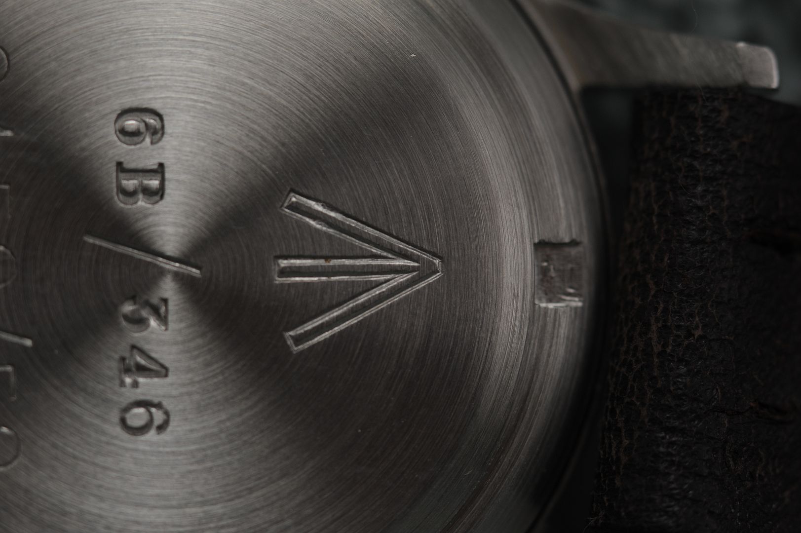

    Todd,

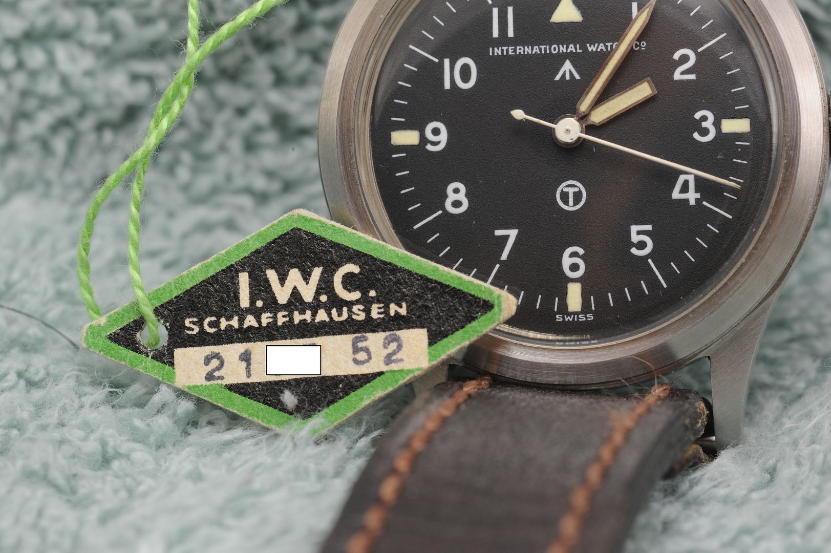

    First time I've ever seen a hang-tag like that with a UK issued Mark 11.

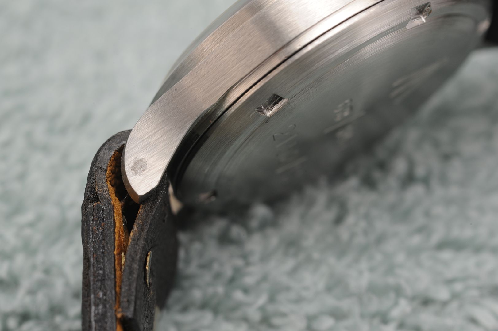

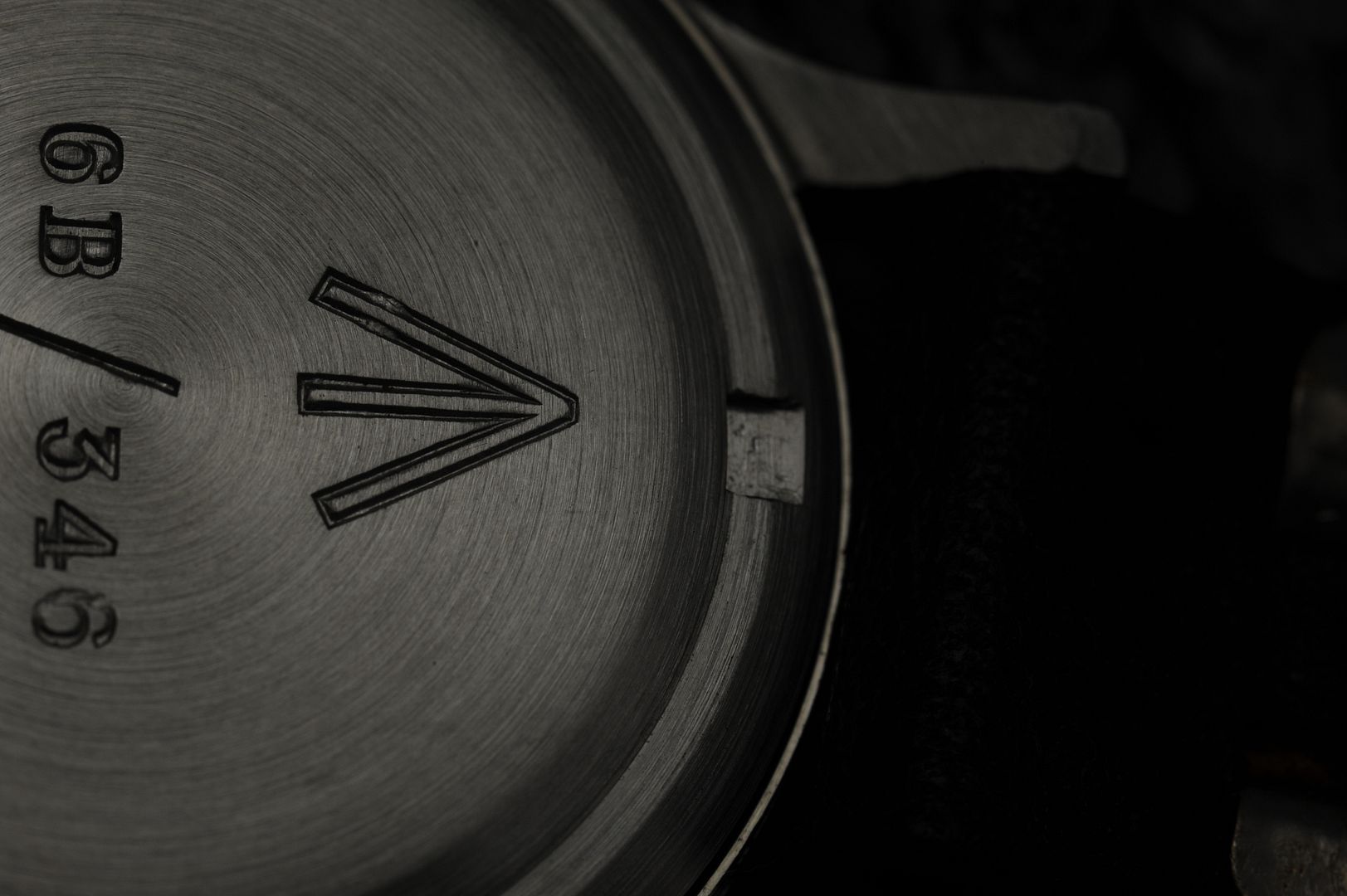

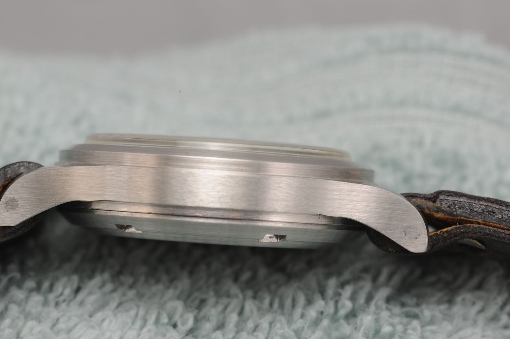

    Also, are you sure that the case hasn't been 'refreshed' at Schaffhausen?
    Ian
    30 Jul 2015, 9:18 p.m.
    It is certainly sporting a recent service crystal...
    Ian
    30 Jul 2015, 9:35 p.m.
    Hi Ian,

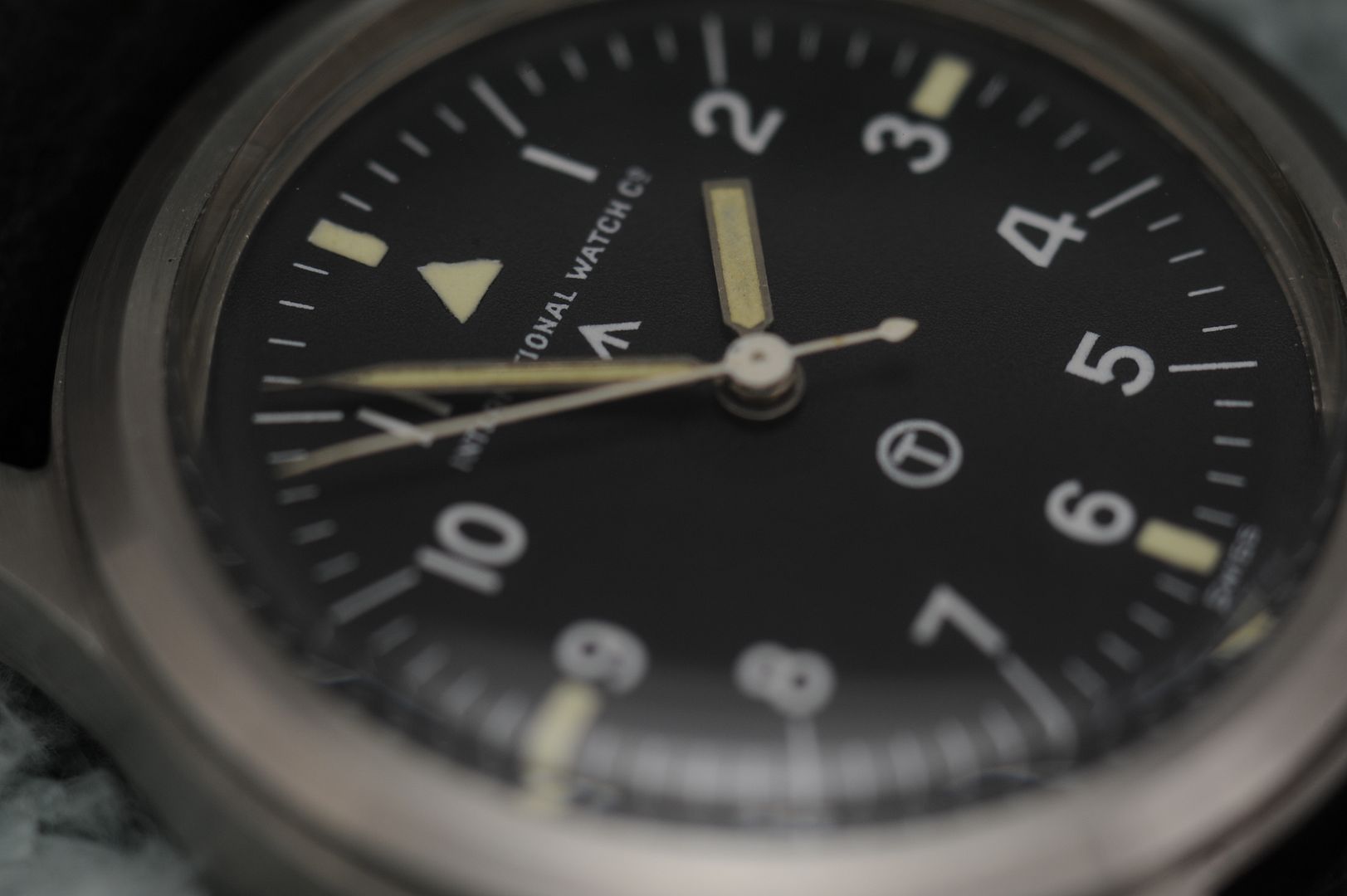

    I am not sure that the case hasn't been refreshed, but my feeling after studying it in the flesh is that it has not been. I took the time to look at it with a loupe last night and have never seen such sharp lines on a restoration.
    The crystal was replaced a few years ago and was noted to be unoriginal in the COA.
    cheers,
    Todd
    30 Jul 2015, 9:50 p.m.
    Todd,
    Sharp lines are exactly what you will get with a careful factory machined refinish.
    These are 60 year old watches. Had this been anything other than truly new-old-stock (i.e. unused, never 'issued' - in which case it wouldn't have been serviced), it would show some degree of scuffing and scratching to the case.
    It's a nice watch, but this is not a piece which I would pay a premium for.
    Ian
    30 Jul 2015, 10:35 p.m.
    Ian,
    The seller represented it as "close to NOS" in that it appears as if it's never been used. This is what the German collector who he purchased it from told him. I know the seller and am inclined to agree with him. As far as the scrapes and dings on the movement...who knows. It may have been serviced in the 70's because the movement was dry. At this point I just don't know the story. Are either of us sure that it was not issued to someone in the service who decided to put it away for safe keeping?
    I do know that I've never seen a nicer one and would pay the premium again for a similar watch. But that's just me.
    best,
    Todd
    30 Jul 2015, 10:40 p.m.
    The watch case has been refinished and the dial replaced, but to me the movement is a bit of a mystery. A case in almost pristine condition and movement showing wear is a bit unconcongruous. And the relatively contemporary strap is inconsistent with a case almost never used.
    I suspect that the refinishing was done perhaps 10+ years ago (especially given the very slight spreading of the luminous compound on the markers), and someone slightly inept worked on the movement afterwards --not Herstmonceux, but more recently. Also, the spotting on the amagnetic plate is inconsistent with good treatment and a well-sealed case (or one never used). The hang-tag I don't believe makes sense for a military issue item but, hey, there's always a first!
    Still, it's a very nice watch.
    30 Jul 2015, 11 p.m.
    yes, the dial is a tritium conversion so it would have been replaced at some point. the strap was thrown on by me last night.
    the case refinished? can you tell me how you can state this with certainty?
    the mystery for me, as you say, is the incongruity between case and movement.
    thanks
    31 Jul 2015, 12:02 a.m.
    Todd,
    I don't think there's any mystery. I believe the case of your watch will originally have shown some light age related wear and scratches (commensurate with the movement condition), but has been carefully refinished to look like new.
    The watch is not NOS. The watch movement has been serviced at least once, probably more. As Michael rightly points out, it has a later replacement (early 1960s) tritium dial.
    I don't believe the hang tag is original. Even if these watches were originally supplied to the UK forces with such tags (which I doubt - this ID not an IWC serial number), this would almost certainly not have remained with an issued and used watch, through at least one service, and until the early 1960s when the dials were changed...
    Just my opinion of course, I may be completely wrong.
    Ian

    The vintage watch market, especially the military market, is full of these stories, concocted to increase the value of a watch at the eyes of the collector. That hangtag on a RAF Mark 11 is particularly ludicrous.
