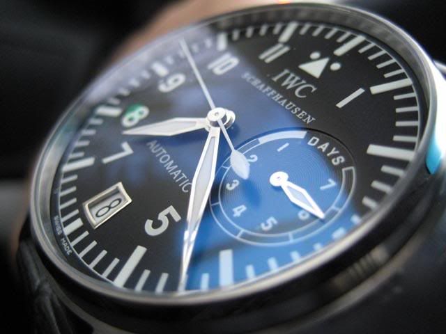

    Hello Fabrice,
    I have tried to find a photo of my early 5002 and see if the 'golden lining'...........................
    i28.photobucket.com/albums/c236/nad1/Big%20Pilot/IMG_6235.jpg
    It doesn't seem to be the case on my BP.
    I never had any issues with the timekeeping on my watch. For the age of the watch it is beating consistently at -11 sec/day ("consistently" being the important word) and I am happy with this until it's time for a service call!!!!

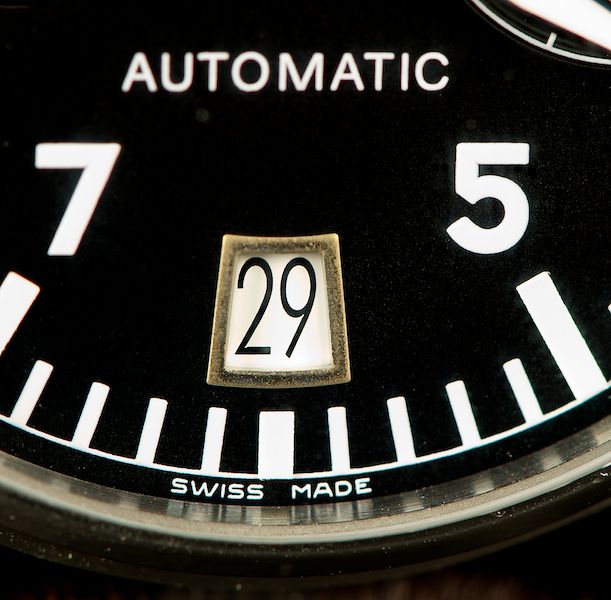

    To the naked eye my slow beat 5002, one of the earlier ones, does not a golden date frame. It appears more like a SS frame. In close up shots, however, it looks golden, but I think that is a function of the lighting and maybe some discoloration over time.
    It is not golden as seen here,
    i95.photobucket.com/albums/l156/wbarker75/Big%20Pilot%205022/DSC_5453.jpg
    But it does look that way close up. You can see the pitting in the frame which can refract the light and change the apparent color to the eye.
    i95.photobucket.com/albums/l156/wbarker75/Big%20Pilot%205022/DSC_5527.jpg

    From about one year after the release of BP the window frame of every 5002 received in the UK workshops has had this 'golden' or matt hue to it. Although the factory have not confirmed it,nor probably never been asked,we reckon the window is silver or silver-plated(rather than rhodium in the 500402). Silver readily tarnishes to a matt, sometimes golden,finish.
    This has nothing to do with the water-resistance of the watch or quality of manufacture but is a natural ageing. It is routine in our workshops to remove the tarnish during service,restoring the original shine(a 5 second operation) but I have noted that watches returned to Schaffhausen for repair don't have the tarnish removed as part of their service. They may prefer the client requests this.
