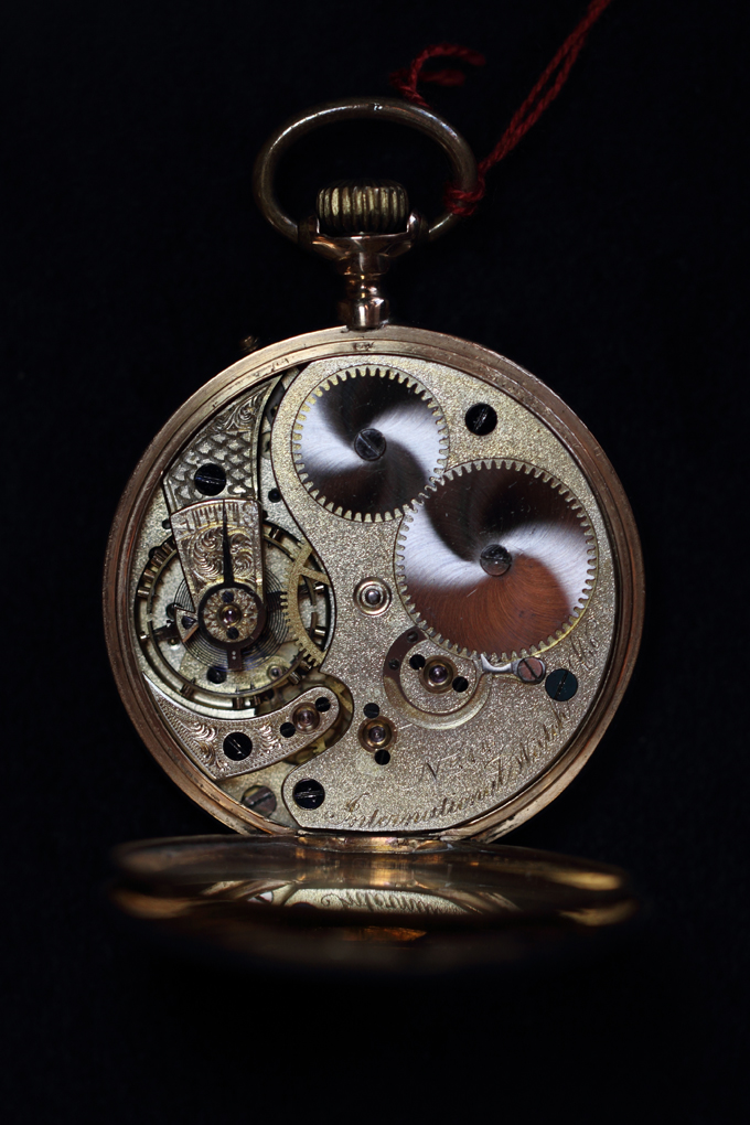

    As the "Pallweber 554" thread became quite big, and this picture is not really an Pallweber, I start a new thread here with "ELGIN I".
    I start it simply with a picture.
    www.vintage-iwc.ch/bilder/c.32_314_m.jpg
    Have fun with it, I like the watch.
    Ralph
    (Sorry for the picture quality, I just made a simple photo an did no rework on it)

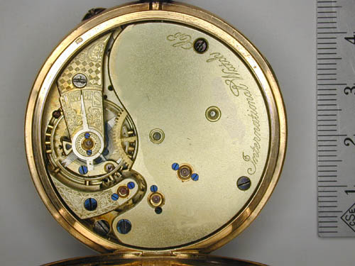

    I don't have any photos immediately handy, but to quickly comment --I too really enjoy the elegance of these movements. But this "elegance" is almost in spite of modern-day finishing standards. Among other characteristics, these movements:
    a) only have brass plates --so much for rhodium, gold, etc.
    b) have no Geneva stripes or similar decoration (aside from really wonderful hand-engraving on the two cocks)
    c) are not "jeweled to the center" and
    d) have a simple regulator --so much for a Swan's neck regulator, let alone a free-sprung balance
    But --to me at least-- these are all besides the point ;)

    Dear Ralph,
    It is really a beautiful watch. The movement n. 314, however, could prove the existence of a batch of the Elgin I, who went beyond the n. 300.
    The problem now are the two Pallweber n. 331 and 350, which may perhaps be prototypes. It would be necessary to verify this issue with other movements that have lower numbers of 500.
    Thanks for the picture!
    Giovanni

    I do not fully agree.
    There are some pictures available (somewhere in theinternet) with Elgin I movements which are white (nickeled) and have something like Genava strips.
    OK this are no c.32/33. This are c.34/35 with hidden winding wheels (à bascule).
    I am still looking for a "fork"-movement (Elgin II) with hidden winding wheels.
    As soon I find such a picture I'll postit here.
    regards
    Ralph

    www.vintage-iwc.ch/bilder/c34kk.jpg
    This is a picture I found on my computer when I was looking for the nickeld Elgin movement.
    After I had this picture, I was searching a long time for more information and to find out, where I took this picture.
    No Idea. Hmmm.
    Looking more precisly, I found it in my brain:
    BEWARE: The picture is a "fake". I tried to explain someone how the c.34 would look like. The picture is a combination of a c.32 and a c.47!
    The ELGIN I with hidden winding wheels.
    So I was trapped in my own trap !
