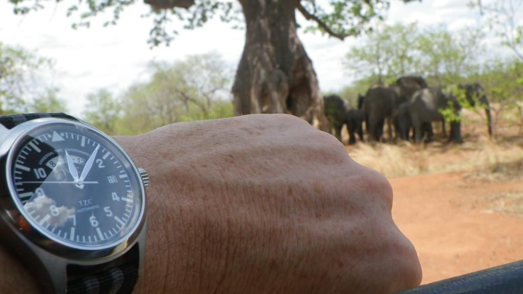

    Hi JerseyGeorge,
    congratulations on your purchase and welome to the forum.
    This is a great watch and there are no "forbidden" times for the date change as this is the idea of the module. I've just had mine back from the spa (this picture was taken before)and now it is as well in mint condition. I love this watch.

    11 Aug 2017, 5:34 a.m.
    Great pic with Elephant in the background. When were you in Africa Tom?
    11 Aug 2017, 8:52 a.m.
    Hi Mark,
    the picture was taken in Tanzania in November 2014. I try to be in Africa as often as possible. Love it and this watch is always with me.
