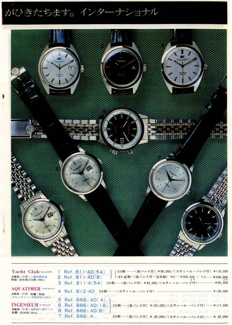

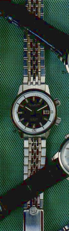

    The following image of a Ref 812 is from an undated Japanese catalogue most probably from the early 1970's
    www.gregsteer.net/IWC/Aquatimer/Japanesecatalogue_Aquatimer_812.jpg
    I've cropped and rotated the image ninety degree to compare it with the bracelets
    www.gregsteer.net/IWC/Collection/Details/Bracelet_Ref_10&11.jpg
    www.gregsteer.net/IWC/Collection/Details/Bracelet_Ref_12&13.jpg
    It is clear the bracelet is a No. 13 and it has an earlier clasp. I don't have the dealer sheet for the Ref 812 to know which bracelet was specified and assume from the above catalogue that the No. 13 was correct.
    Interesting to note the No. 12 bracelet has a safety clasp where the others do not. Maybe it was specified for the Aquatimer Ref 1812/1816 in the dealer sheet posted by Stanford because of the sporting nature of the Aquatimer and the reduced risk of the bracelet disengaging.

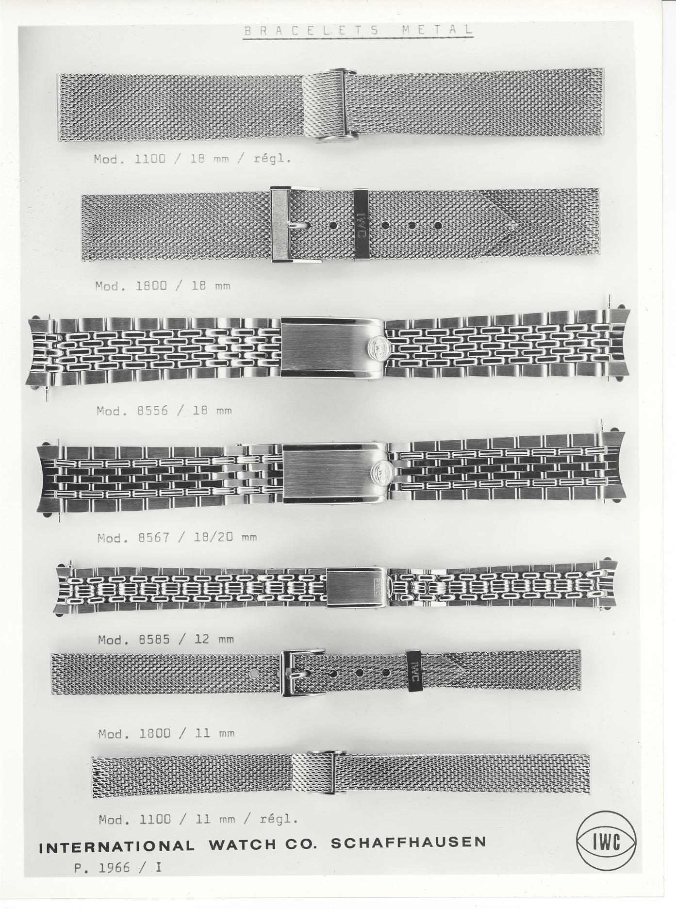

    Christian Niemann (Nemo) once posted the following image and it has bracelet model numbers that pre-date the Ref 11,12,13....
    Note the clasp is the same as shown in the Japanese catalogue
    www.gregsteer.net/IWC/I_Images/bracelets-1.JPG

    Cool old catalogue picture! This sheds some light on why ive been seeing what i thought was mixed clasps/bracelet combinations - might be year related...?
