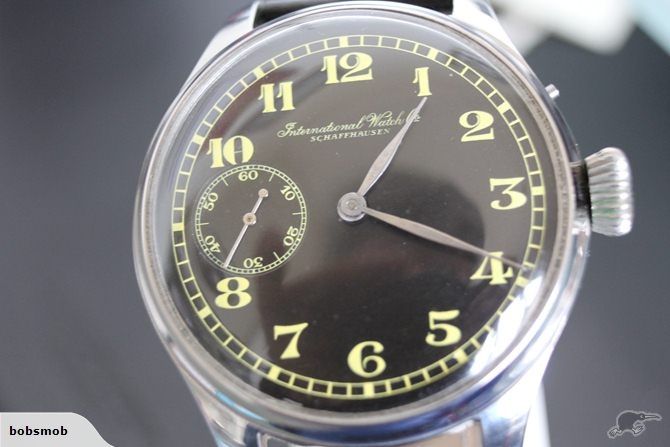

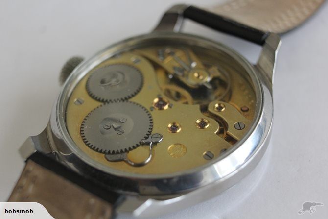

    I would be interested in the opinion of the experts on this forum.
    [i556.photobucket.com/albums/ss6/Waikato7/image_zps76a70847.jpg](s556.photobucket.com/user/Waikato7/media/image_zps76a70847.jpg.html)
    [i556.photobucket.com/albums/ss6/Waikato7/image_zps6ca89a3f.jpg](s556.photobucket.com/user/Waikato7/media/image_zps6ca89a3f.jpg.html)

    The movement is. All the rest, case, dial, hands, is not.
    22 Sep 2013, 8:13 p.m. 22 Sep 2013, 8:13 p.m.
    clepsydra has written:
    Thought as much.
    Thank you.
    22 Sep 2013, 10:32 p.m. 22 Sep 2013, 10:32 p.m.
    Again, if you see an IWC-labeled watch with sub-seconds at 9 o'clock, and it is not (a) a minute repeater nor (b) a chronograph, it's a marriage.

    What is that little button at the 2 position on the case?
    23 Sep 2013, 11:54 a.m. 23 Sep 2013, 11:54 a.m.
    WatchJunkie has written:
    It's a travesty.
    23 Sep 2013, 12:34 p.m. 23 Sep 2013, 12:34 p.m.
    I assume it is a pin set pocket watch movement. You push the button and turn the crown to set the hands, rather than pulling out the crown.
    I can't argue with Ralph's assessment though.

    I assumed it wasn't. But then you think, "I better ask, just in case".
    I can't argue with Ralph's assessment though.[/QUOTE]
    Fair enough!
