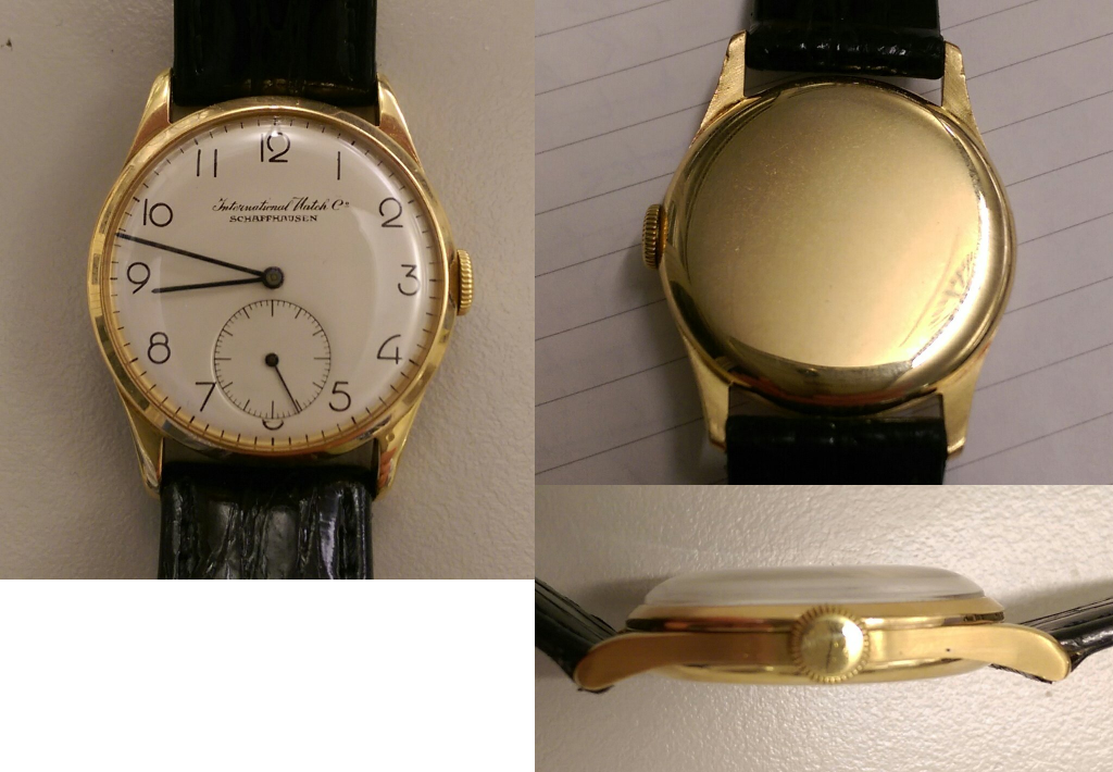

    Hello all,
    I have recently bought a beautiful watch - as you can see in the attached picture.
    Supposed to be a IWC ~1938 Caliber 83 Portofino 750k Gold watch.
    I love the art deco style and the watch is in perfect condition.
    However I am not sure if this is a genuine IWC watch.
    I could not find this art deco style dial anywhere in the catalogs.
    Can anyone help? I would love to learn more about this watch.
    Many thanks in advance!
    Morton
    i300.photobucket.com/albums/nn28/MHastings/MyPortofino_zpsfld5u4bz.png
    2 Mar 2015, 9:51 p.m.
    I can't say if it's genuine but 1938 the name Portofino was not born for IWC's watches. That has been around 1985 I think with the moonphase Portofino watch.
    The dial looks strange in a way but as stated, I am not an expert for vintage watches.
    2 Mar 2015, 9:58 p.m.
    Totally fake.
    I don't think an 83 beats inside.
    2 Mar 2015, 10:04 p.m.
    I don't think it's a fake, the case looks good. The dial is correct with recessed sub-second scale. Although it appears to be repainted with a bit of creativity and artistry.
    If you can open the case back and show us the movement, we can tell you more.
    2 Mar 2015, 11 p.m.
    case is not from IWC
    crown is not from IWC
    hands are not from IWC
    dial is not repainted (font is not from IWC) but "fantasy"
    3 Mar 2015, 12:44 p.m.
    Only a view inside can clarify a C.83.
    My opinion is: Someone has found a "C.83", adapted a dial and put in into a case with a fitting diameter for the movement.
    That means fake.
    HEBE
    3 Mar 2015, 12:53 p.m.

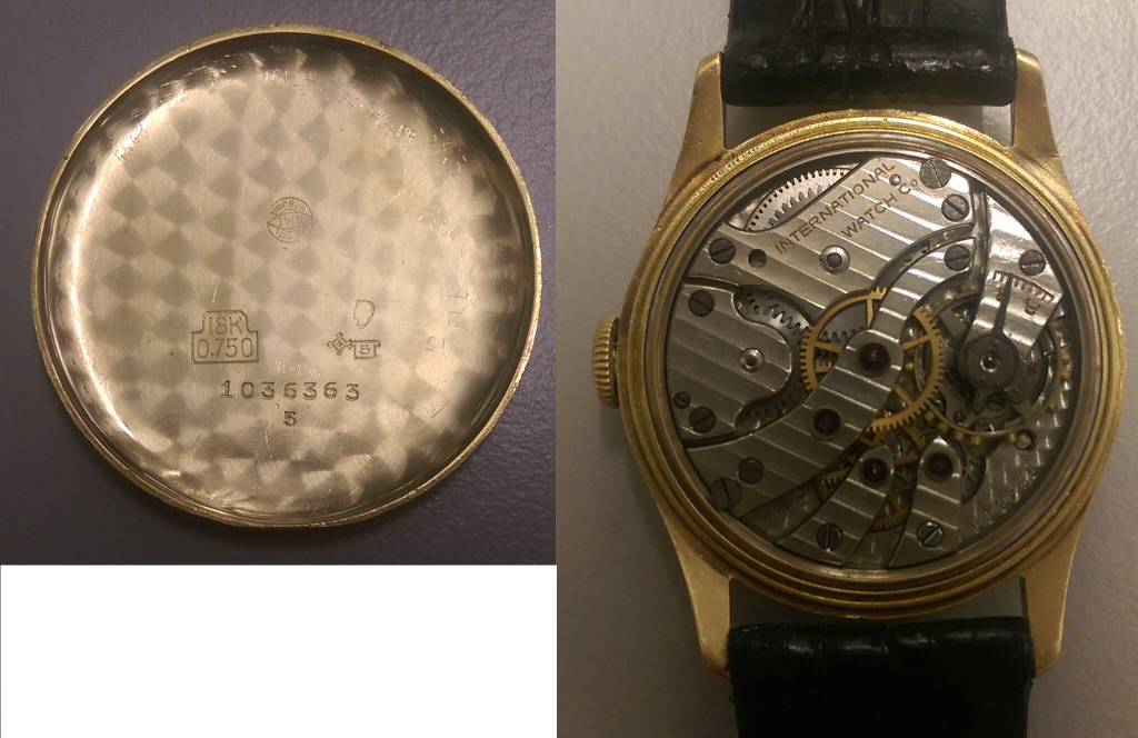

    3 Mar 2015, 7:16 p.m.
    Here is picture of the movement and the inside of the case lid.
    The case (1036363) and movement numbers (994809) show up in the catalog, but not sure how much that tells anything...
    i300.photobucket.com/albums/nn28/MHastings/Inside_zpsrgddglpi.png
    Let me know your view.
    Thanks!
    Morton
    3 Mar 2015, 7:37 p.m.
    It tells a lot and it makes me change my former opinion !
    Indeed an authentic IWC case back with a C.83.
    So, only the dial looks strange.
    HEBE
    3 Mar 2015, 9:05 p.m.
    On the case - see the photo I posted of the back.
    The hands are very simple, blue-ed steel, but look similar to catalog item 38 of the attached IWC catalog from the 40s.
    www.iwcforum.com/Catalogs/1940sFournitures/f6_p1a.jpg
    The dial I have not found anywhere, closest are the dials number 9 or 8 of the catalog items below (also digit "4" in dial 11) - but the numbers are still a bit different in style (more pure art deco):www.iwcforum.com/Catalogs/1940sFournitures/f6_p1c.jpg
  • 3 Mar 2015, 10:03 p.m.
    Hello Morton and welcome to the forum. I am with Hebe, I only have questions about the dial, never saw a font used like that.
    Case and caliber are in great condition. I hope that someone can confirm the dial is OK.
    I had a quick look at the dials found on www.iwcforum.com/Vintage_Catalogs.html
    and didn't found any similar dials.
    4 Mar 2015, 12:36 a.m.
    The dial is repainted but the watch otherwise the watch is original. But also it's not a Portofino model.

    5 Mar 2015, 6:04 p.m.
    I confirm my mind: case, dial, hands are fake.
    Back is probably from IWC but heavely polished (outside).
    Movement seems to be an original IWC83 (to look better, from real).
    5 Mar 2015, 6:23 p.m.
    LOVING2000
    On what do you base your conclusion?
    This is definitely not an "ugly" watch! I stand by my original statement.
    5 Mar 2015, 6:47 p.m.
    Dear Mark,
    Fake watches are always "ugly" (the worst of ugliness).
    In my prevoius comments I've already explain why I think that.
    The dial is not repainted because don't reproduce an original IWC font, it's just fantasy.
    Somebody has taken an IWC movement, probably an IWC gold back and put all together.
    Personnaly I find the final result unwatchable.
