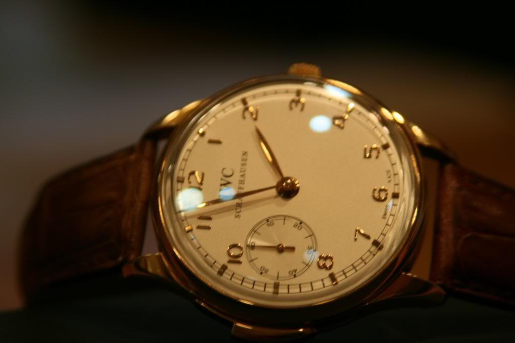

    i1266.photobucket.com/albums/jj528/AJHM1/IMG_2773_zpsc90e5f89.jpg
    2nd time lucky. I posted 4 photos on the 1st attempt but they were blocked. So here is my 2nd attempt with 1 photo. Ciao
