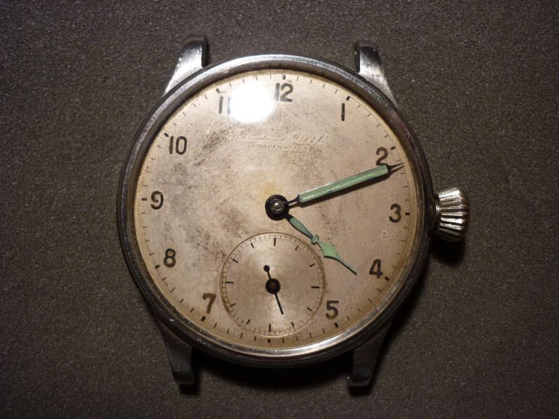

    Hello,
    new here.I add pictures (hope visible) of my watches.I think they are Portuguese,
    ref 325.Because I did not open it till this time I have no numbers from inside.
    Working condition.Can somebody help me with year of production and confirm that hands and crown are original?
    Thank you

    Hi George,
    Ref 325? Perhaps, but you have to provide the case and movement numbers to be sure. If you do not want to open it, just give us the case diameter, excluding the crown.
    I can tell, however, that the hands have been horribly repainted and are most likely not original, and neither is the crown.

    Hi George, welcome and though I'm not a 200% vintage expert, I've seen enough 325's to at least question crown and hands. The true experts will most likely react but serial numbers are essential to determine its origins.

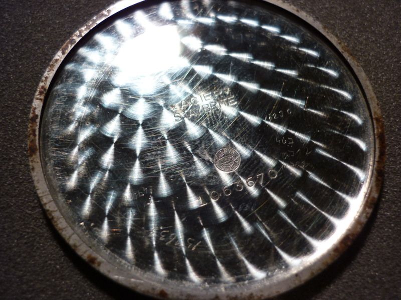

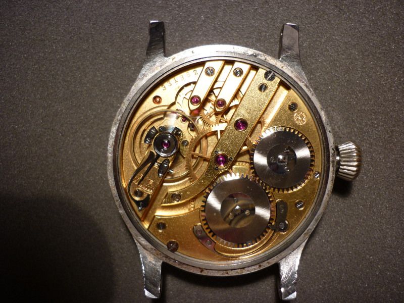

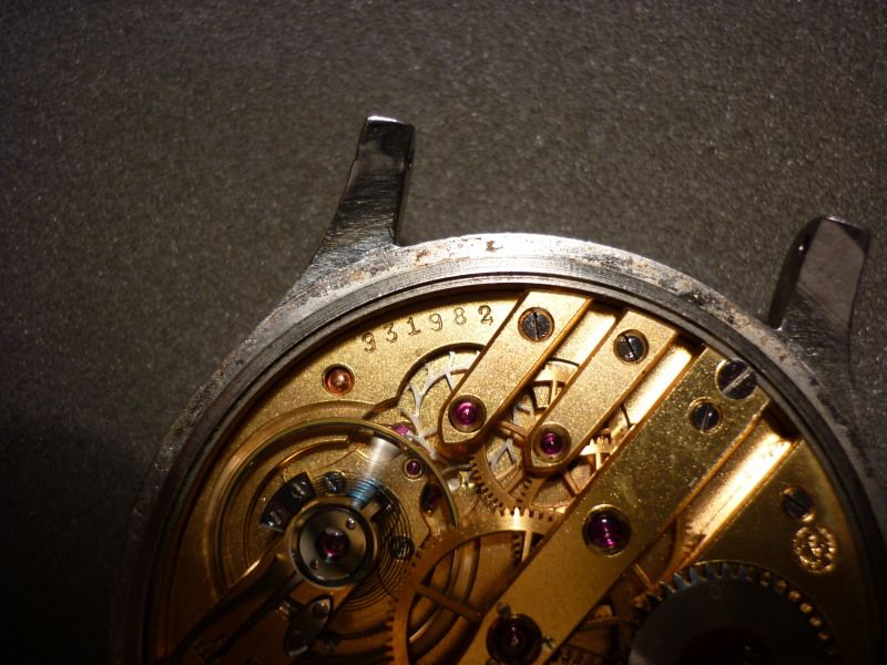

    back again. According your instructions I use service of watchmaker.Job was done and results you will see on pictures.
    i1375.photobucket.com/albums/ag464/moodmedia1/Portug5_zpsaada262a.jpg
    i1375.photobucket.com/albums/ag464/moodmedia1/Portug3_zps73bc98b0.jpg
    i1375.photobucket.com/albums/ag464/moodmedia1/Portug4_zps68abb77f.jpg
    Thanks 8541 for direct photos in text.
    best
    George

    Congratulations. It is a Ref 325, original Portuguese, with cal 74 manufactured in 1942 and one in the first batch of 36 Ref 325s made that year. IWC made a second batch of 72 Ref 325s in 1942, to a total of 108.
    IWC manufactured a grand total of 690 Ref 325s over 42 years; 304 with cal 74 between 1939 and 1951; 329 with cal 98 between 1944 and 1970; and 57 with cal 982 between 1977 and 1981.
    As you can see you have rare IWC icon deserving professional attention.

    Hi George,
    It is possible to obtain a Certificate of Authenticity from IWC, but the watch will have to be inspected in Schaffhausen. This CofA is expensive, but well worth it for a Ref 325.
    The only way to obtain this CofA is through the IWC Authorised Dealer closer to you, who will ship to to Schaffhausen.
    With the Ref 325 in Schaffhausen, you may wish to consider doing a movement overhaul, replace the hands and the crown, and clean the dial. I am not in favor of dial restoration on the Ref 325, unless the dial is severily damaged, which is not your case. The case needs cleaning, but not polishing. This will not be cheap, but well worth it on an original Portuguese.
