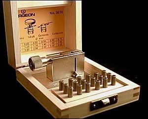

    Almost all hands, loosened by repeated removal, can be retightened by IWC watchmakers for secure fitting and reuse with a tool like the one pictured below:
    [i1152.photobucket.com/albums/p489/leosweeney/Handtighteningtool.jpg](s1152.photobucket.com/user/leosweeney/media/Handtighteningtool.jpg.html)
    As Michael pointed out, IWC owners can always relay specific requests like, 'Please keep tritium dial/hands or fish crown', when sending their watch in for estimate whereupon all possible efforts will be made by the watchmaker to repair/reuse the components without compromising the continued functioning of the watch or the service warranty.
