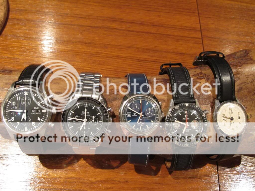

    Yup, I am aware of the problems you have been having. I have read about your frustrating time and could feel that Your opinion was influenced by your Current experience. I hope you get resolution soon. I on the other hand have had excellent and reliable service from my chronos and I have pieces ranging from 1950 to 2012. Here are somei1335.photobucket.com/albums/w680/regnimelf3717/IWC/IMG_2777_zps3087d8d1.jpg
    28 Oct 2013, 3:46 a.m.
    Hi Mark, nice collection Indeed!
    You are correct about my ongoing issues, this however lead me to the following - although chronos are very popular, how many are actually used and benchmarked by their respective owners?
    Owning 20 "chronograph" watches , and using them as standard time tellers, unfortunately do not relate to the reliability of the complication.
    Chris
