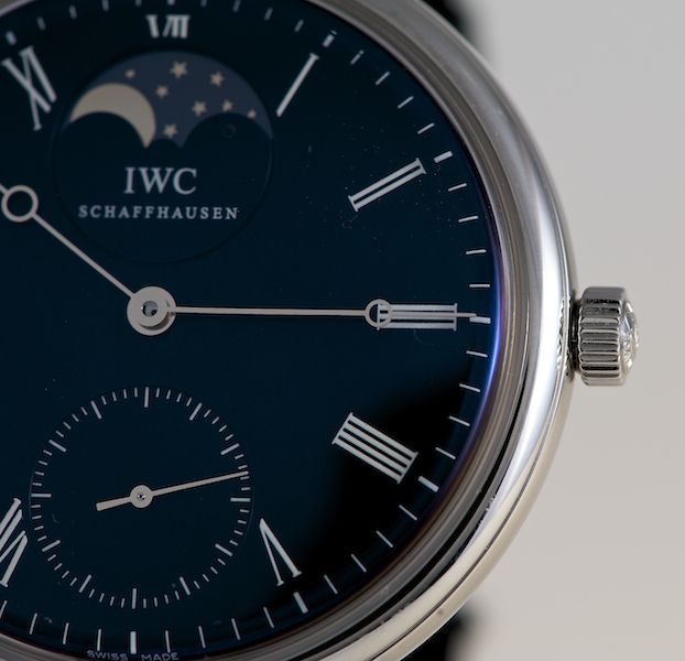

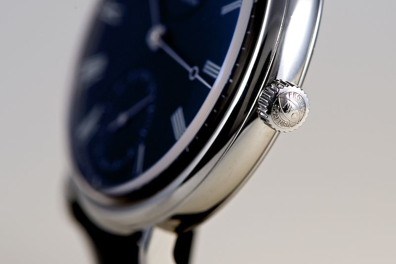

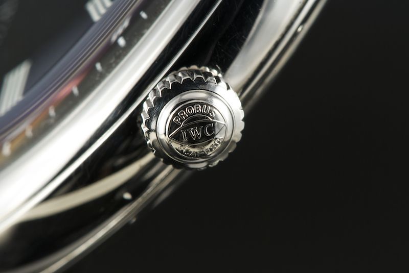

    Here are before and after shots:
    OLD:
    i95.photobucket.com/albums/l156/wbarker75/Portofino/DSC_4365-1.jpg
    i95.photobucket.com/albums/l156/wbarker75/Portofino/DSC_4577-1.jpg

    NEW:
    i95.photobucket.com/albums/l156/wbarker75/Portofino/DSC_6757.jpg
    i95.photobucket.com/albums/l156/wbarker75/Portofino/DSC_6756.jpg
    i95.photobucket.com/albums/l156/wbarker75/Portofino/DSC_67581.jpg

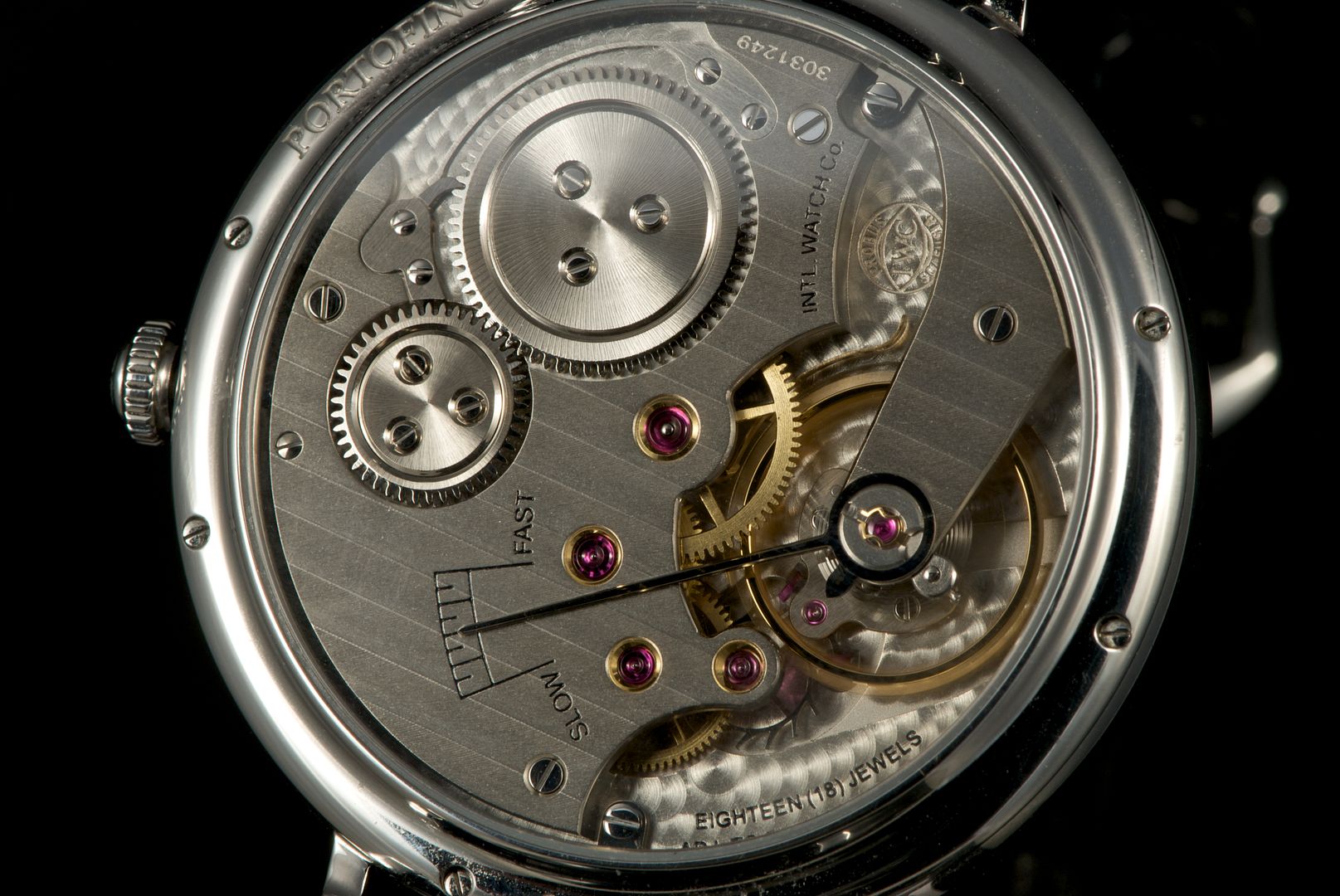

    As an owner of the original Portofino and someone who sold the VC Portofino because of the crown issues, the problem has never been the crown; it has always been the movement.
    [img.photobucket.com/albums/v281/RAVE54/L1020499.jpg](smg.photobucket.com/user/RAVE54/media/L1020499.jpg.html)
    The crown on the 5251 is even smaller but the watch is a delight to wind. The tension and the sound of the winding is perfect. The Jones movement is a different experience altogether.
