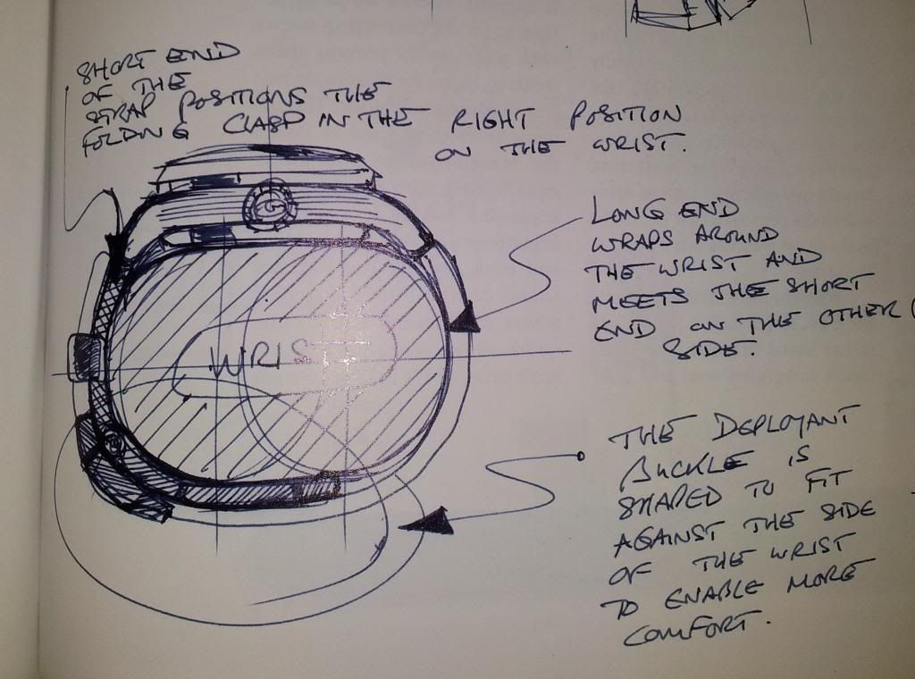

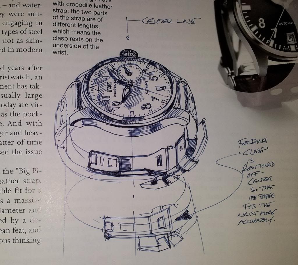

    There was an article in the old WATCH magazine about straps.
    Basically, the clasp need to positioned as illustrated:
    i207.photobucket.com/albums/bb46/toseebeyondthesky/e0b34146-ae1d-4660-9424-48d9a56f3b96.jpg
    i207.photobucket.com/albums/bb46/toseebeyondthesky/2cb538e8-8133-497b-89ae-82b338fc17b5.jpg
    I hope this helps.

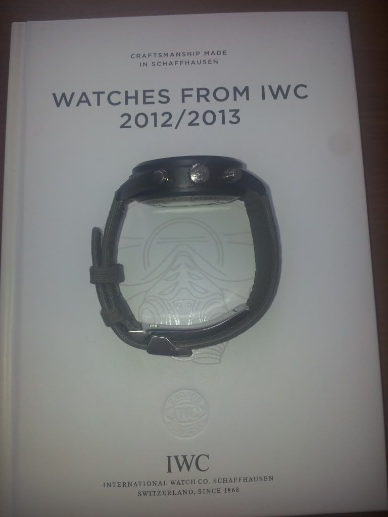

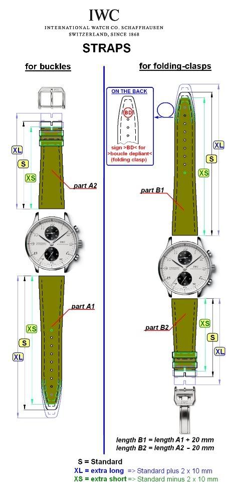

    and this.
    i207.photobucket.com/albums/bb46/toseebeyondthesky/Strap101.jpg
    ...and here are my application on my own:
    i207.photobucket.com/albums/bb46/toseebeyondthesky/20130706_114934.jpg
    i207.photobucket.com/albums/bb46/toseebeyondthesky/20130706_114716.jpg

    Great post!
    I have seen different sizes specified on this site, so even with looking around, i am still a big confused.
    I have seen
    XS: 135/55
    S: 145/55
    XL: 155/55
    and
    XS: 125/45
    S: 135/55
    XL: 145/60
    I am sure this is std v's deploy ant sizing, but doesn't match the +10 on each side mentioned in the picture (unless its 145/65).

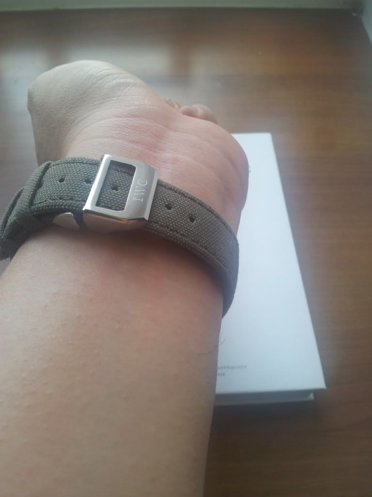

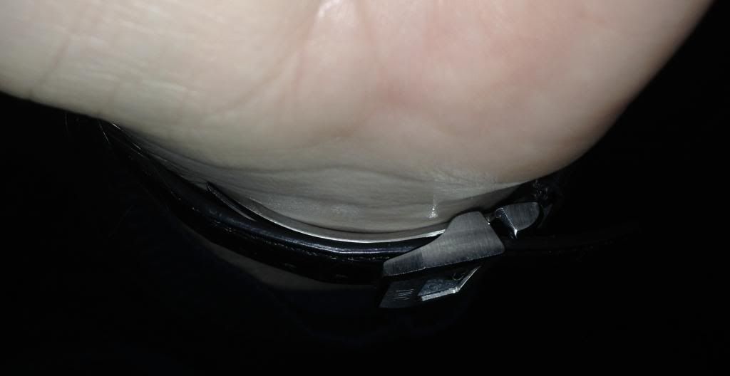

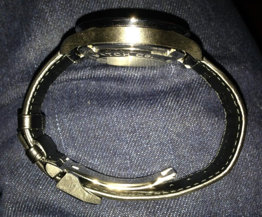

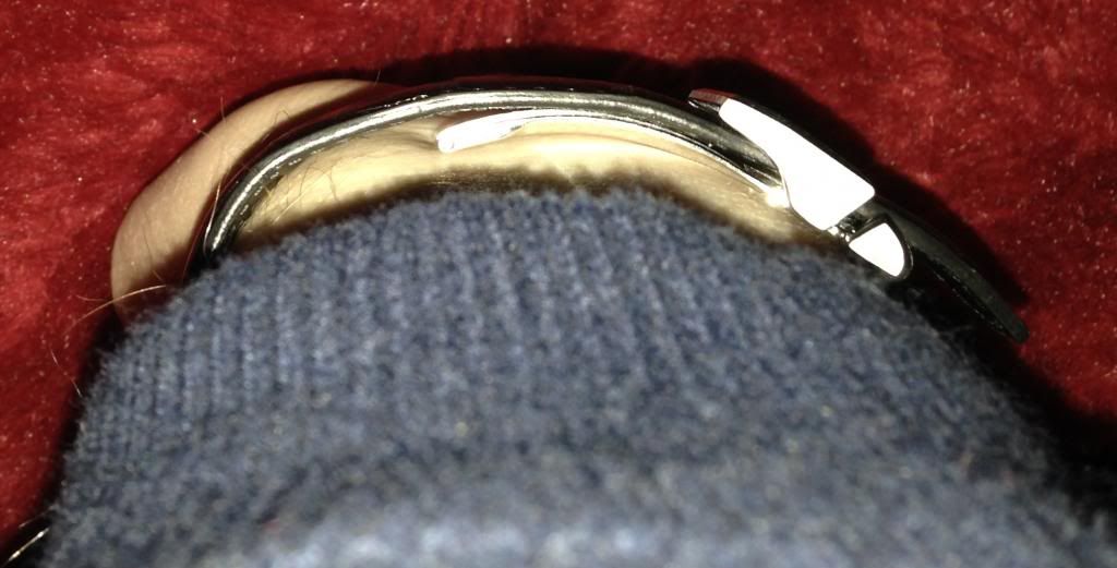

    to help others that may have the issue, here are some shots of how it is currently:
    i840.photobucket.com/albums/zz324/swilli40/IMG_0546_zps0abc71dd.jpg
    i840.photobucket.com/albums/zz324/swilli40/IMG_0543_zps1e5d0a17.jpg
    i840.photobucket.com/albums/zz324/swilli40/IMG_0541_zpsd43bb9ed.jpg

    Very nice! Are those sketches printed or your own artwork?

    I don't know all of the lengths but can verify that an IWC XS Deployant strap is 125/45. You can extrapolate from that.
    Based on your photo, it looks to me like you have the strap setup to be very tight on your wrist. This is, of course, personal preference but perhaps try it looser for a few days and maybe you will like the result.

    its on the last hole, so can't be looser...
    22 Nov 2013, 10:40 p.m. 22 Nov 2013, 10:40 p.m.
    It appears a XL strap is in order.
    Mr. shane williams
    Apprentice 8 posts
    22 Nov 2013, 10:43 p.m. 22 Nov 2013, 10:43 p.m.
    andy stevens has written:
    agree, its looking that way. If i get the short length to be 65mm (needed to rotate to right position), then i will go for it. :)

    Not my sketches. These are from an IWC published magazine(WATCH) as mentioned.

    These drawings and pic's are teriffic for visualizing how a deployant should be worn. Thanks for sharing.
    @ SWILLI40 ... I truly believe a XL will do the trick. As you can see, if you center the "folding clasp" and let the buckle fall naturally, it will end up a bit off centered. But this is correct as it makes it easier to unhook because you get better leverage than if it was more centered. BTW, unhooking is less cumbersome if you grab the sides of the buckle with your thumb and pointing finger, apply moderate squeezing pressure and lift up. This method is much better than trying to lift the buckle from the end.
    Finally, should you go with the XL strap ( and again, I think that's the answer ), you can also mix the Standard size with the XL strap and that will create a new hole pattern to choose from as well as alternative fit positions. Try it, nothing to lose !

    I agree, I also think the strap is too tight.
    I have noticed a strap on deployant wears totally different compared to a strap on pin buckle, and allows for a more relaxed fit.
