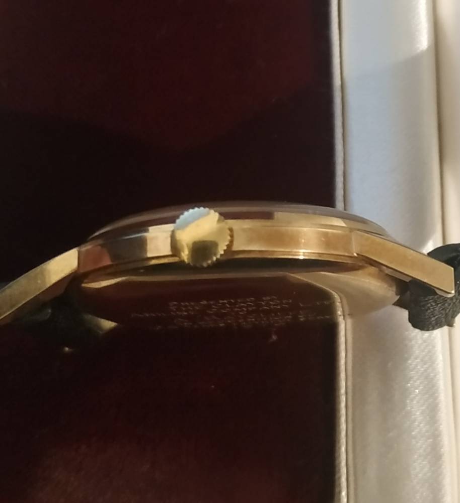

    Hi,
    I inherited this watch from my Great Grandfather a good few years ago and I've
    never been able to pinpoint which model it is or a year. I believe it's
    cal.88, but all my searches only bring up watches that are similar but not
    exactly the same (e.g., there is no part of the number 6 visible whereas the
    images I'm finding all have a partly visible bottom of the number 6).
    I'd appreciate any help/advice that identifies the specific model and year.
    Watch has been in the box since it was presented to my Great
    grandfather

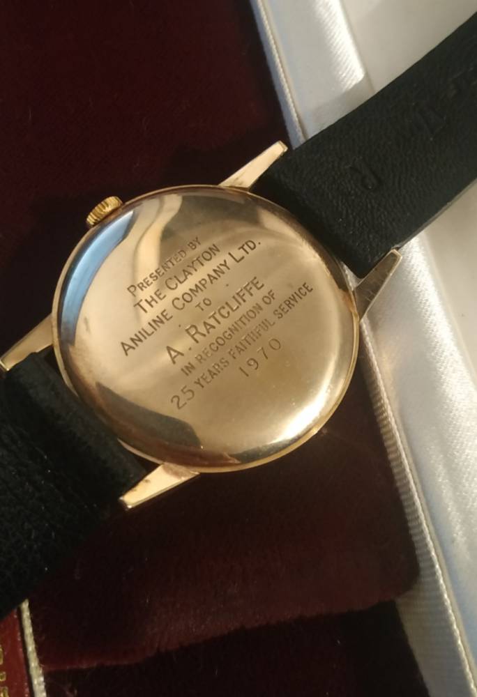

    I took the watch to a Jewellers and they took the case back off for me and
    said the hallmark is 9ct Gold dated between 1970-1971.
    It is Cal.88 - My only other question is in regard to the serial number
    stamped on the caseback - It doesn't seem to match up with 1970 as the date.
    The watch was bought from Garrard and Co Jewellers - might they have ordered a
    special batch of these watches to sell as 'retirement' gifts?
    Many thanks,

    The caseback serial number is curious?
    What is the serial number on the movement, there next to the regulator - I
    cannot make it out?

    Do you think the case back may be not original and provided by the jewellers
    for the purpose of being engraved?

    I've just taken some better pictures of the movement and case back. Thanks so
    much for your
    help!
    Master 3225 posts
    25 Jul 2020, 9:27 p.m. 25 Jul 2020, 9:27 p.m.
    Thank You for the clearer pictures.
    The case still remains a mystery however. In most Cal 88 and 89 models, the
    movement spacer ring is usually stamped METAL , which is not visible here.
    The movement number confirms it to be Cal 88 produced in 1962.

    My opinion (you maybe dont like it):
    IWC movement recased on an other Brand case, not an IWC model / Ref.
    regards

    Hi SRPHOTO,
    the D.S & S Hallmark in the Caseback is from an english case manufacturer
    named David Sutton & Sons.
    It is not unusual to find IWC movements in cases produced by other
    manufacturers.
    The IWC factory ledgers would tell if the more if the movement was sold with
    or without case.

    Greg Steer
    Master 2688 posts
    27 Jul 2020, 11:18 p.m. 27 Jul 2020, 11:18 p.m.
    Suspect the case is from D Shackman & Sons NOT David Sutton & Sons
    www.silvermakersmarks.co.uk/Makers/London-DS-
    DZ.html
    Note no Dot after the final S
    Some details of the firm can be found on the following link
    www.vintage-watches-collection.com/watch/omega-watch/omega-gold-with- box-and-papers-1974/
    Cheers from the cellar
